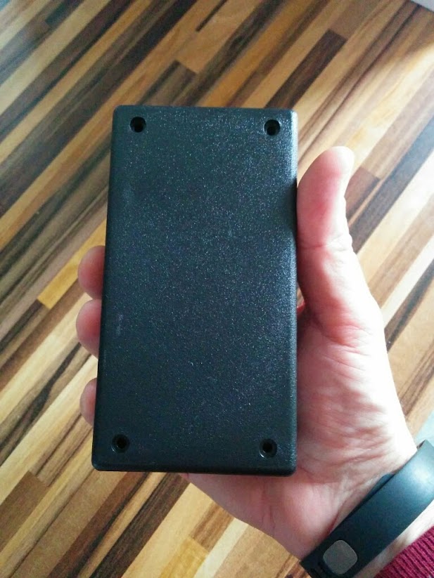

I then took my project box

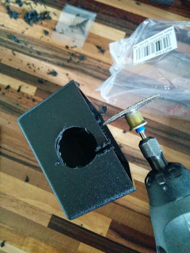

and drilled a 20mm hole, then used a cutting disk to create an opening for the ODBII cable.

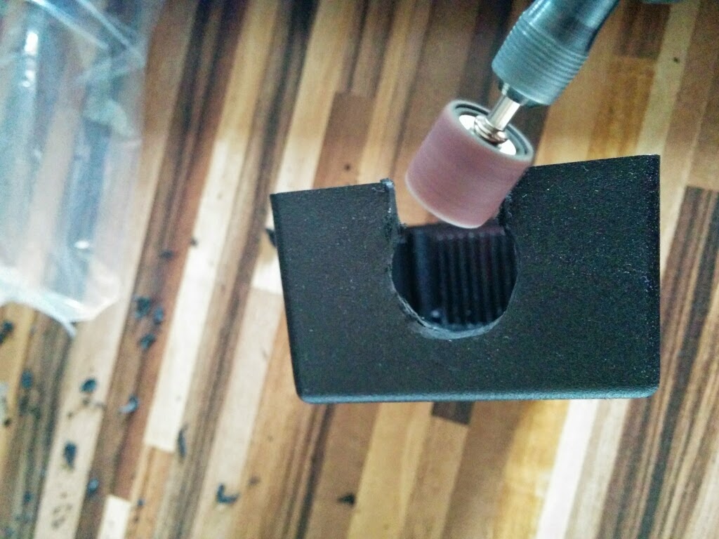

Sand off the rough edges with a sanding drum:
Now place the ODBII port (and in my case my Bluetooth adaptor) within the project box and screw the lid on - I used security screws for this to make life trickier but you may want to just use the crosshead screws supplied with the box:
