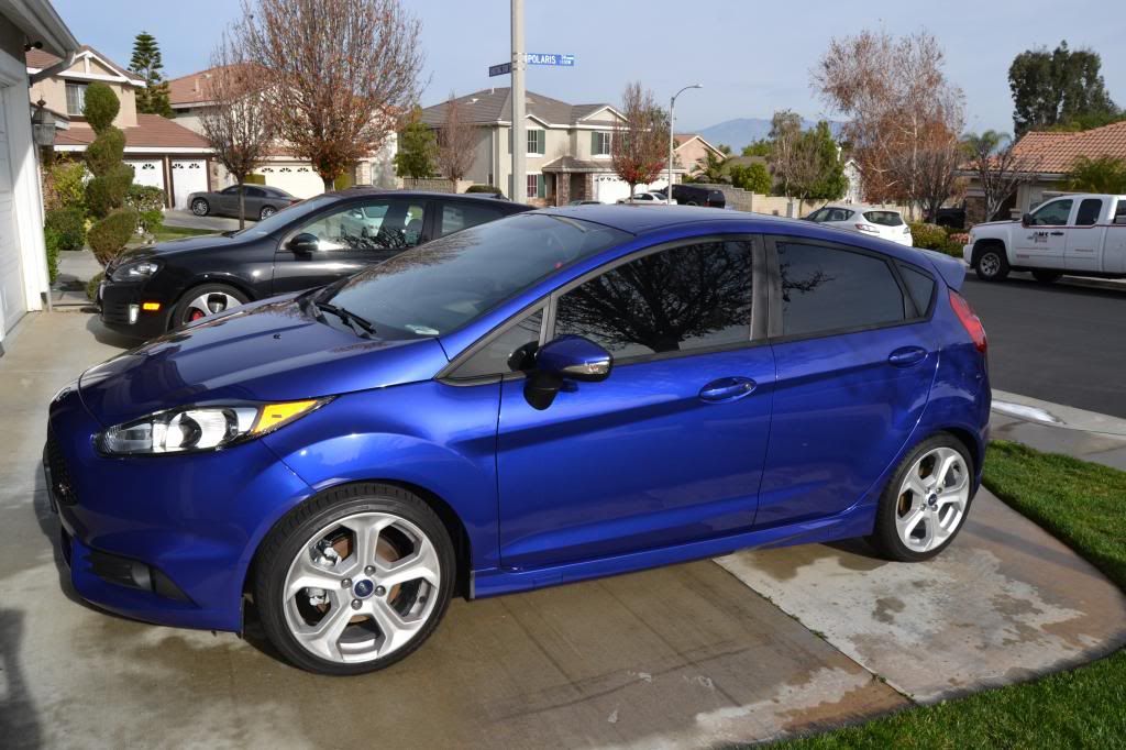

My first mod was a window tint, which is both an appearance mod and an interior mod since it keeps interior temps lower. Plus it looks cool.
This is what my FiST looks like after the 3M ceramic tint. Cost $300.00

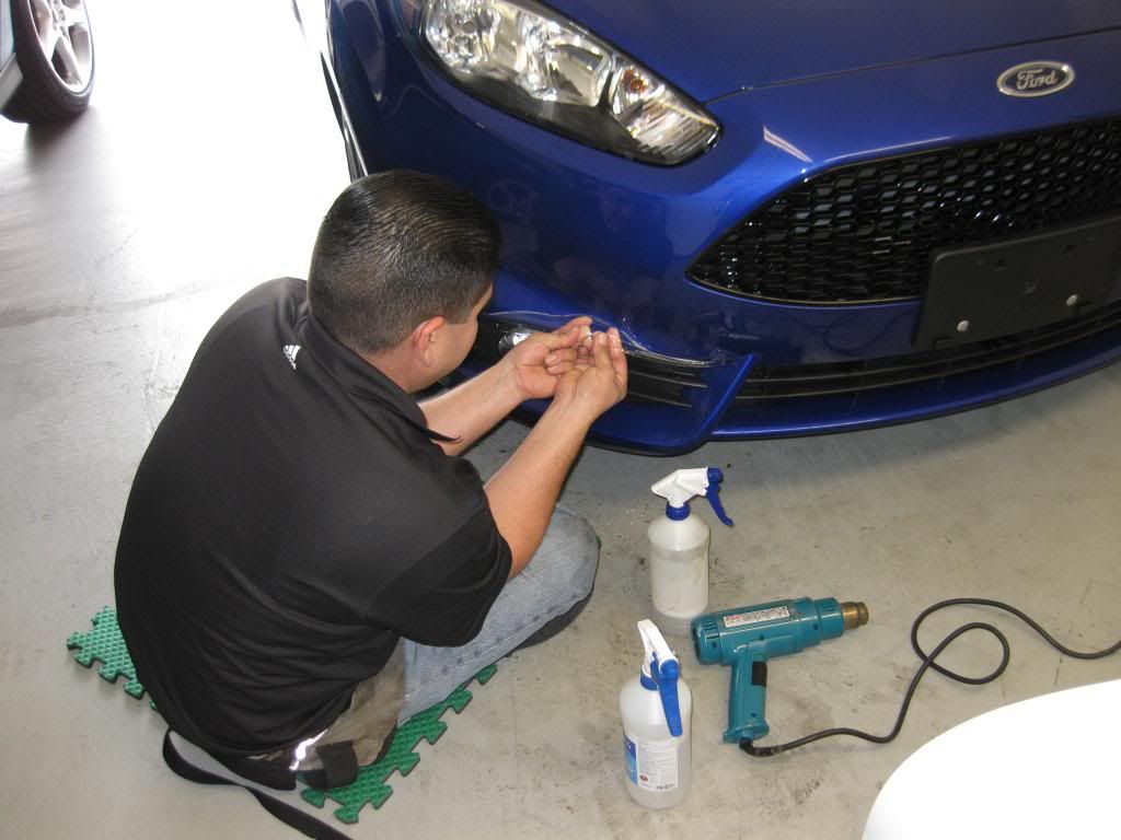

Next, I applied a clear bra to the hood, mirrors and front end. Cost $600.00

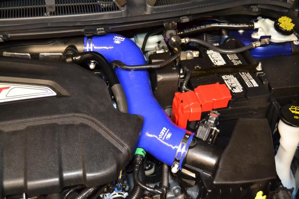

Next mod was a mountune high flow induction hose. Cost $189.00

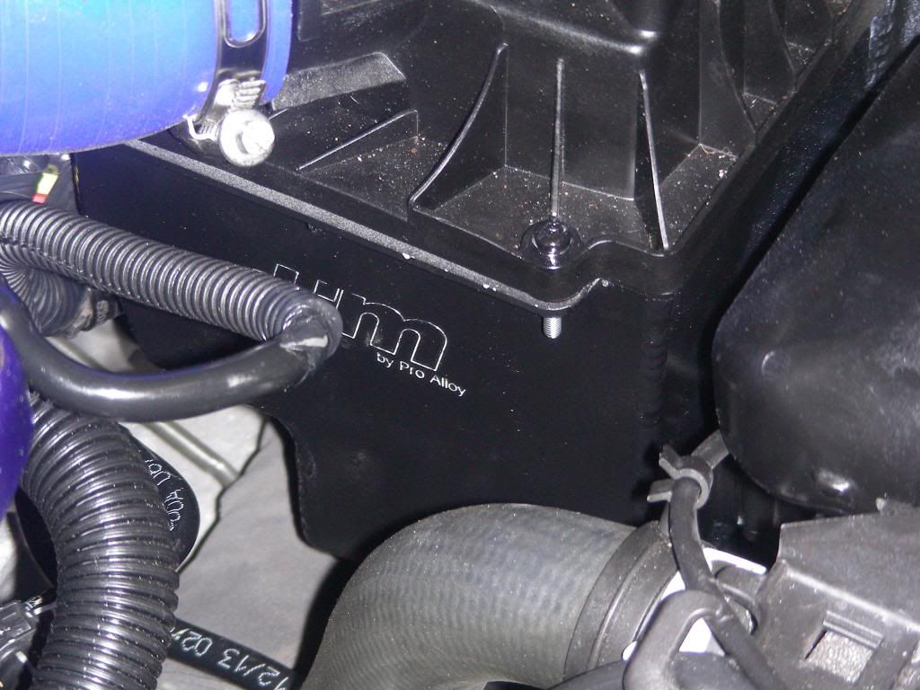

I also installed the Mountune air box. Since I live in SoCal, I painted the outside of the box black to match the OEM box. I also painted the fastener heads black.

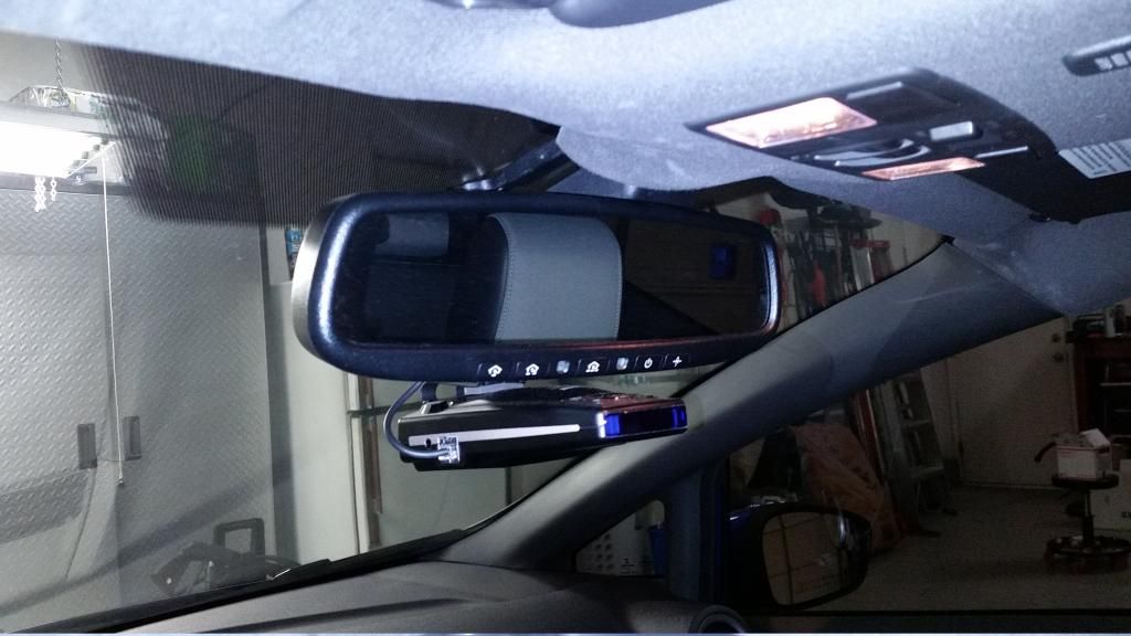

I also installed an ebay directwire kit to connect my Escort 9500IX radar detector. I used a mount from escort to attach the detector to the rear view mirror. The Directwire was $6.29. The rear view mount was $79.00. I used an add a fuse, on a 20 amp line, fuse # 11 for the windshield wipers. I cut the end of the Directwire, and removed the inline fuse, and soldered all wires up. Only the add-a-fuse powerline was crimped. There is a panel on the passengers side you can remove to enable routing of the wire from the fuse panel to the radar detector.

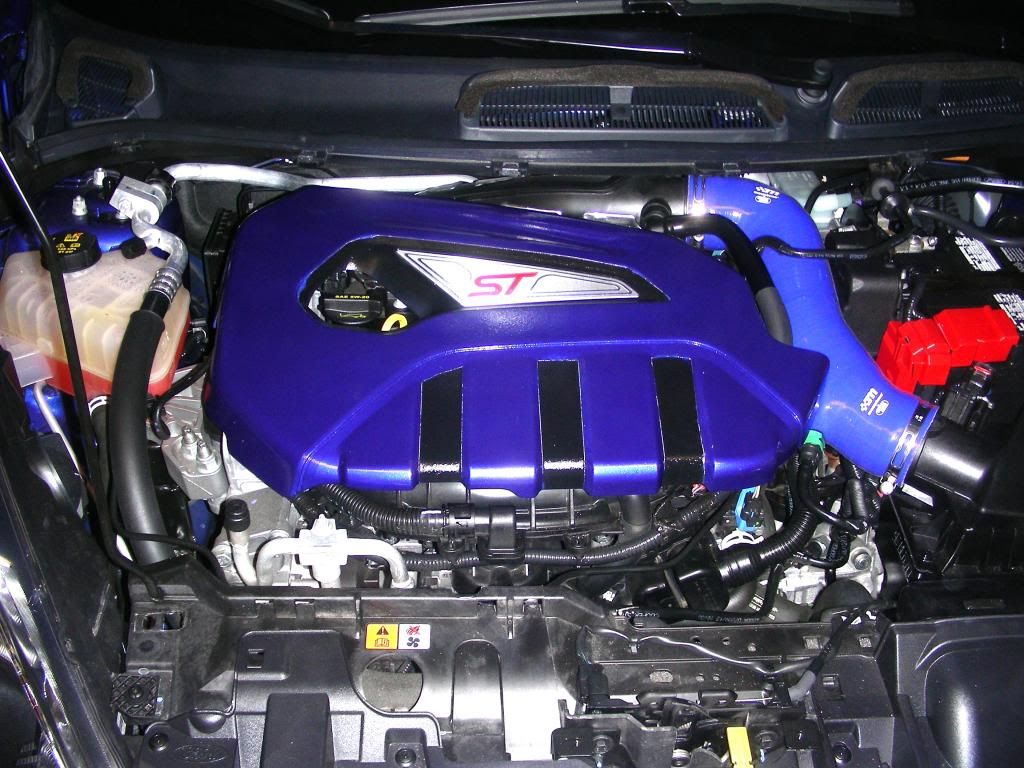

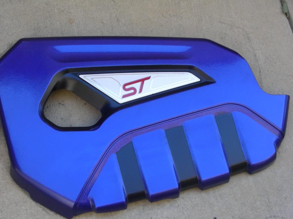

Then I got some performance blue in a rattlecan so I could paint the engine cover. Here is the finished result.
Installed in the engine.
Here are pics of the mirror, escort and wiring install

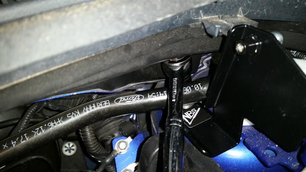

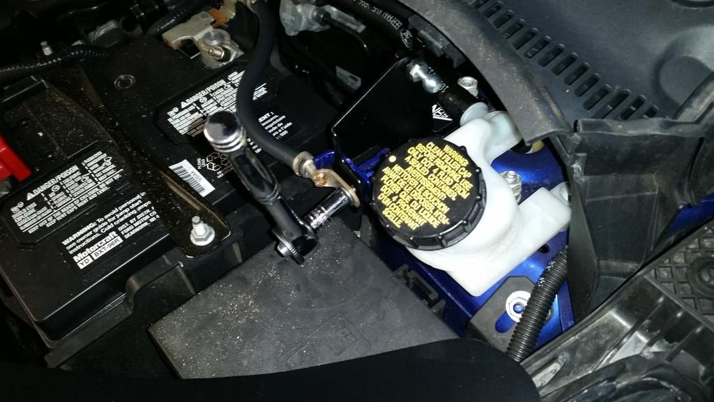

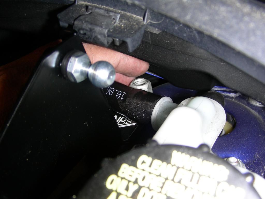

Yesterday I added a SiCo development hood strut. Cost was about $120.00, a little pricey, but the hydraulic strut works great. It comes with instructions, but the pictures are small. Here are some pics of the install.
The strut fits on the right side of the engine. you need to remove the ground bolt on the strut and one of the strut nuts to attach the btacket. I also had to remove the left nut on the brake fluid remote filler to bet the bracket to fit.
I've inserted the bracket and am reinstalling the strut nut.
Tightening down the fastener for the brake reservoir.
Tightening down the ground strap.
Finishing up tightening the strut nut.

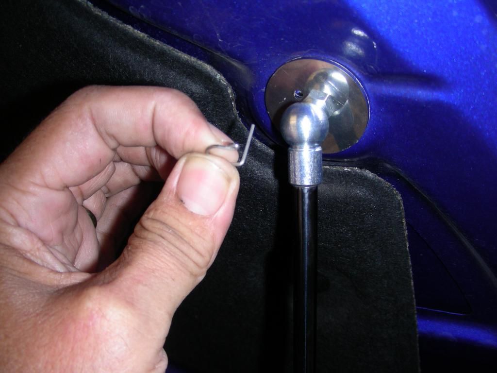

Installed the hood strut attachment ball. This has a split c washer on it. You insert it into a hole in the hood, then tighten it down. Very well engineered. The instructions say to use a jewelers screwdriver to aid in tightening, but you can pull down on the c washer while tightening.
Each end of the gas strut has a small pin you remove and reinsert after mating the end of the strut to the bracket or the hood ball.
Finished up.

Discussion Starter · #6 ·
Not bad!
I dont know how I feel about the engine cover, looks like it could use a bit more touching up? But great start on the mods!
Actually I was waiting for the paint to harden, before I wet sand and buff. Also, the lighting was fluorescent shop lights which makes everything look bad. Check out the pic taken on the concrete outside.
